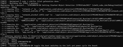

It seems that model compiling succeeded but failed when flashing.
And this is the YAML file I edited:
Furthermore, example binaries in stm32ai-modelzoo-services/application_code/ works fine via CubeProgrammer, but failed when I run model-zoo-service python script.
How can I deal with the issue?

Successfully solved the problem by downgrading CubeIDE from 2.0.0 to version 1.17.0.
nctuemoAuthorBest answer
Associate
December 1, 2025

Hi @nctuemo,
I did not replicate it. Not sure the version was the cause of your issue.
Make sure the bottom led next to the USB is green when flashing.
With multiple screens plugged to my pc, I sometime have to unplug them to flash. Probably a lack of current.
Have a good day,
Julian
