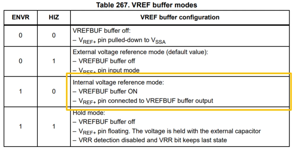

The internal voltage reference can be configured in four different modes as shown below in the table found in the STM32H723’s reference manual:

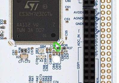

Step 1. On your STM32 board’s schematic, locate the connection between VREFP and VDDA. You will want to make sure that this connection between VREFP and VDDA is removed, as this could cause a short and damage to the microcontroller when configuring the internal voltage reference mode.

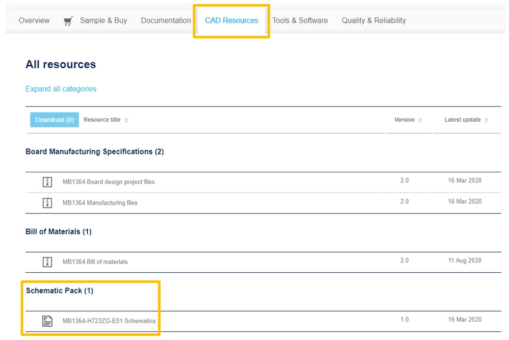

Each STM32’s respective board schematic can be found on the board’s landing page under the CAD resources tab.
In our case, checking the Nucleo-H723ZG’s schematic, there’s a 0-ohm resistor connection between VDDA and VREFP that must be removed.

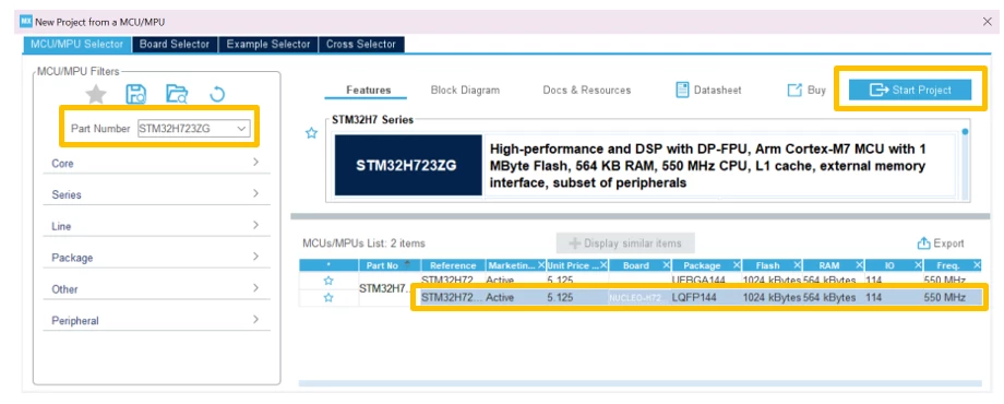

Step 2. Using STM32CubeMX start a new project with your selected STM32.

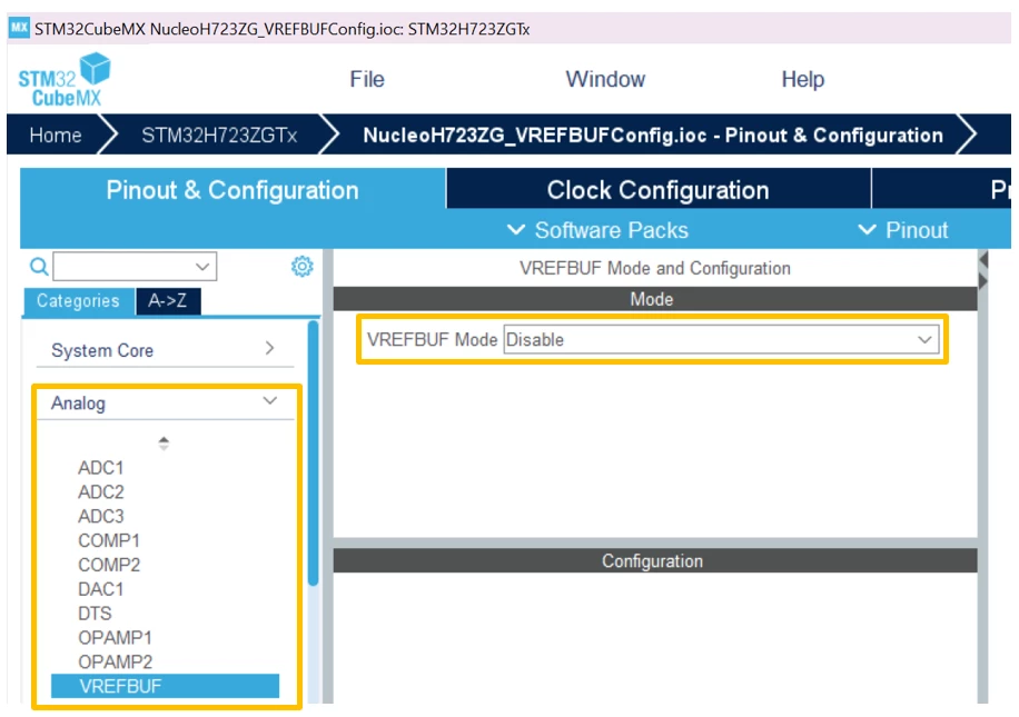

Step 3. The VREFBUF configuration is found under the ‘analog’ drop down category. By default, the VREFBUF mode is disabled.

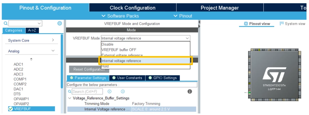

Step 4. From the dropdown menu, select the ‘internal voltage reference’ option.

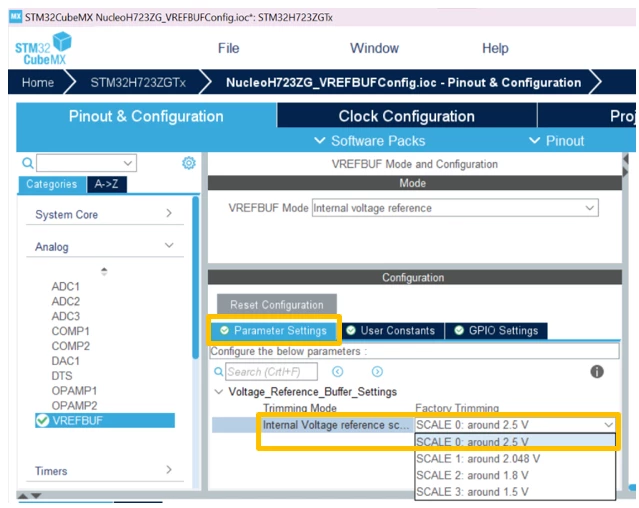

Step 5. Under the ‘parameter settings’ tab below, select the scale that you want for the VREFBUF value. In our example case, we will select SCALE0: around 2.5V.

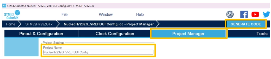

Step 6. Under the ‘project manager’ tab, give your project a name, save the project and generate the code in STM32CubeMX. Then flash the newly STM32CubeMX’s generated code to your STM32 board.
