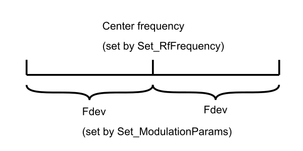

Is the following interpretation of the FSK frequency parameters correct?

I also used a spectrum analyzer to confirm that my diagram about the frequency configuration is indeed correct. The frequency set by Set_RfFrequency is indeed the center frequency (not the lowest or highest frequency) and Fdev means the deviation of the symbol frequencies from the center frequency (half of the total difference from the "0" symbol frequency to "1" symbol frequency). The center frequency is actually never sent.

I am also unsure what frequency exactly is set by "Set_RfFrequency" - is it the center frequency, or perhaps the lowest frequency (for "0")?
