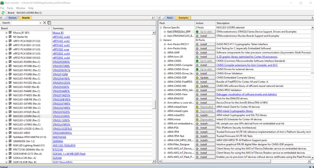

Hi all,
We are about to start evaluation in the following development environment specified by the module manufacturer.
ST Micro NUCLEO-L073RZ
Keil μVision V5 ( V5.29 )
STM32cubeMX  (V 6.0.1 ,STM32Cube MCU Package for STM32L0 1.11.3)
We cheked the Pack Installer in the μVision,

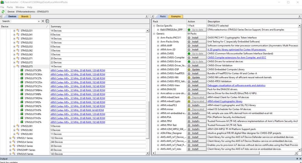

in the devices tab, we can select the STM32L073RZ,
in the boards tab, we can not select the NUCLEO-L073 only L053RB.
please cheke attached the files.
what should we do?
Please advise how to deal with this problem and how to solve it.

Hello @sss_jpn ,
Same issue is shared here
I confirm that there is no Board Support Pack available for the NUCLEO-L073RZ, but this target is listed in the Device tab:
To solve your issue, could you please refer to this link, Pack with Board Support (keil.com), shared in this discussion.
I hope this help you!
