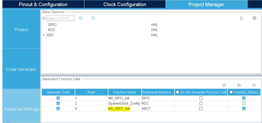

Otherwise, the Advanced Settings Tab in CubeMX interface gives the possibility of choosing not to generate code for some peripherals or middlewares: This automatic initialization code generation can be disabled per peripheral or middleware in the Generate code column:
0693W000007CgKeQAK.pngWhen the Generate code checkbox is unchecked , void MX_ADC1_Init(void) function will not be generated in main.c file () (or adc.c file will not be generated if the option Generate peripheral initialization as a pair of '.c/.h files per peripheral is checked).
if the Do Not Generate Function Call checkbox is checked, STM32CubeMX does not generate the call to the corresponding MX_ADC1_Init . It is up to the user code to do it.
