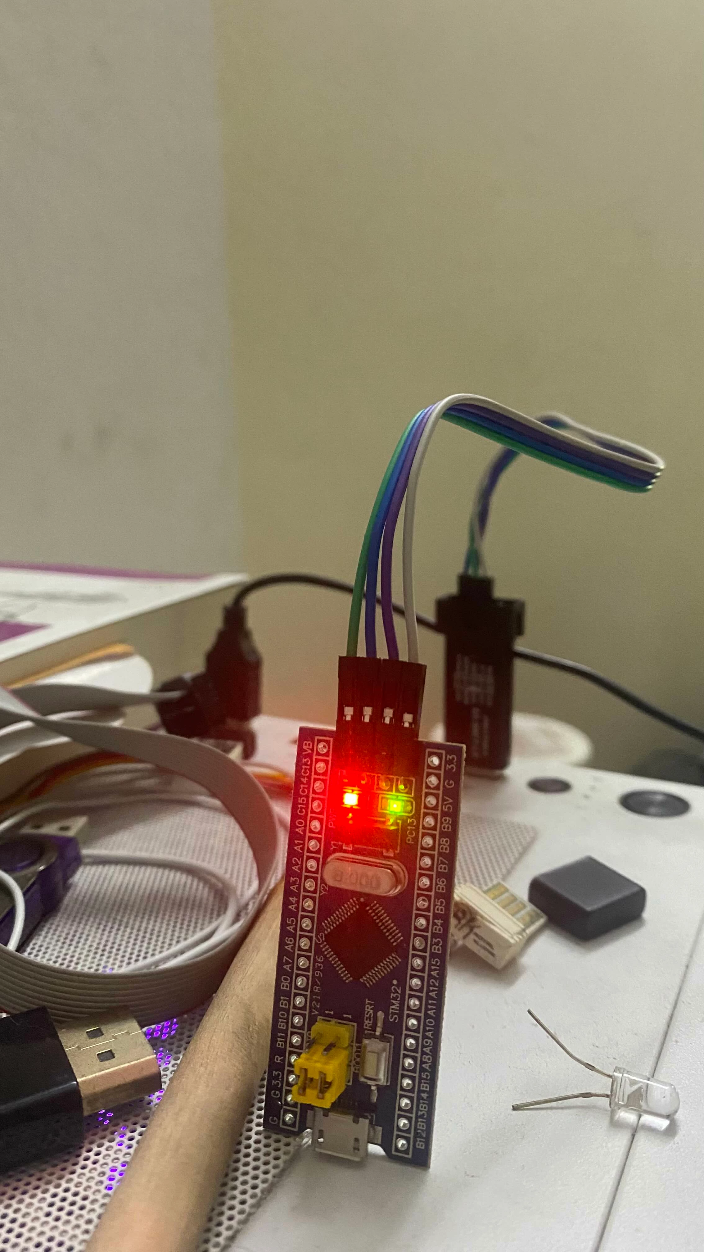

Hi, I'm getting started at embedded programming, I've got this blue pill board having the STM32F103C6 MCU and ST-LINK v2 programmer.
Here's my code, just to light up the LED on port C 13:
#include "stm32f10x.h"
int main() {
RCC->APB2ENR |= (1<<4);
GPIOC->CRH |= ((1<<20) | (1<<21));
GPIOC->CRH &= ~((1<<22) | (1<<21));
GPIOC->BSRR = (1<<13);
return 0;

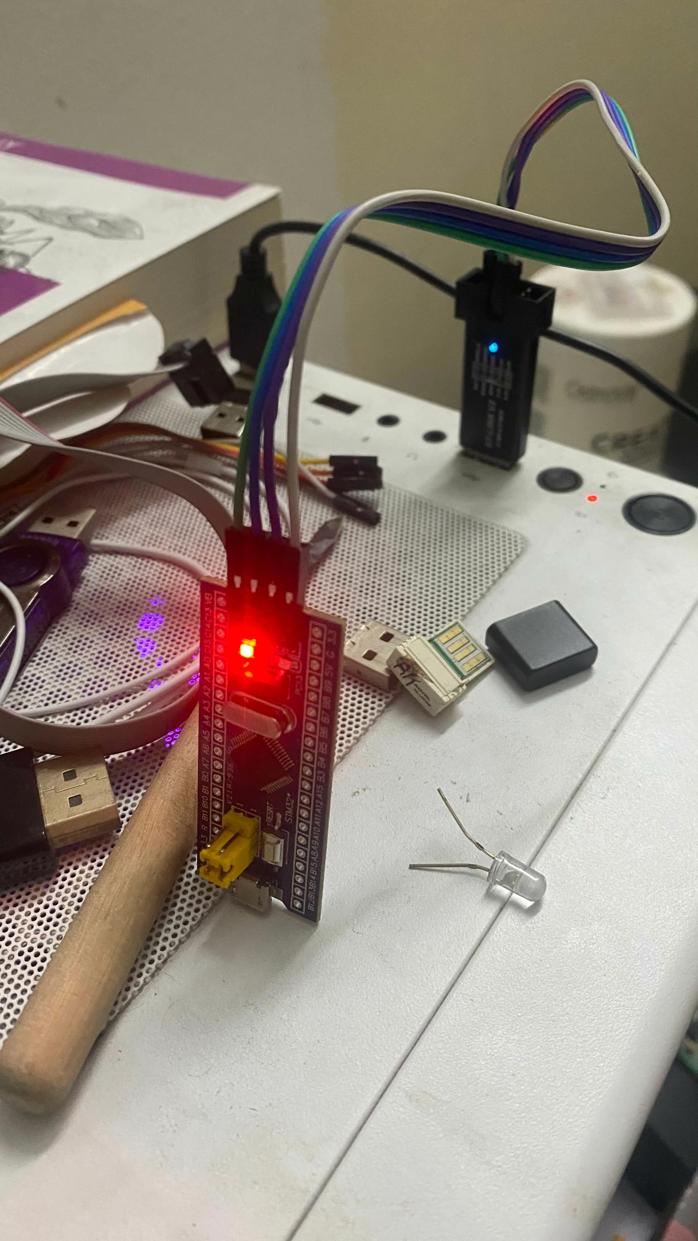

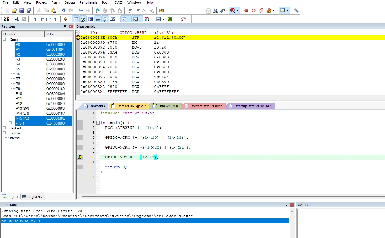

Despite the IDE flashes successfully the LED doesn't light up as I wanted, It will only lights up if I add a break point on debugging mode on Keil uVision

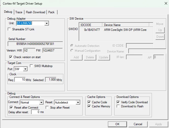

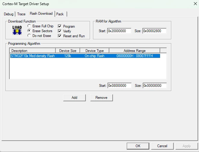

And here are my flash configurations:
Any help is appreciated.
Best answer by Pavel A.
which is weird because it turns on while setting the register and turns off when setting the set-bit = 1.
What I expected. Some LEDs are "active low". TL;DR this is not unusual, just depends on how the LED is connected.

But I was trying to turn it on, it doesn't light up if I was not in Keil debugger mode and having the command paused at

Try using HAL code, check the HW works with that. I don't have a strong desire to validate others bare-metal coding.
Watch also for the clock hazard related to enabling the GPIO's APB clock and then immediately writing it's registers.
In Keil you should be able to do a Peripheral View of the GPIOC bank, and manually modify the registers, and toggle the PC13 pin.

I did make such a mistake. After fixing bit register 21 -> 23, the LED turns on at
GPIOC->CRH &= ~((1<<22) | (1<<23));
and turns off at
Pavel A.
Pavel A.Best answer
Super User
September 11, 2025
