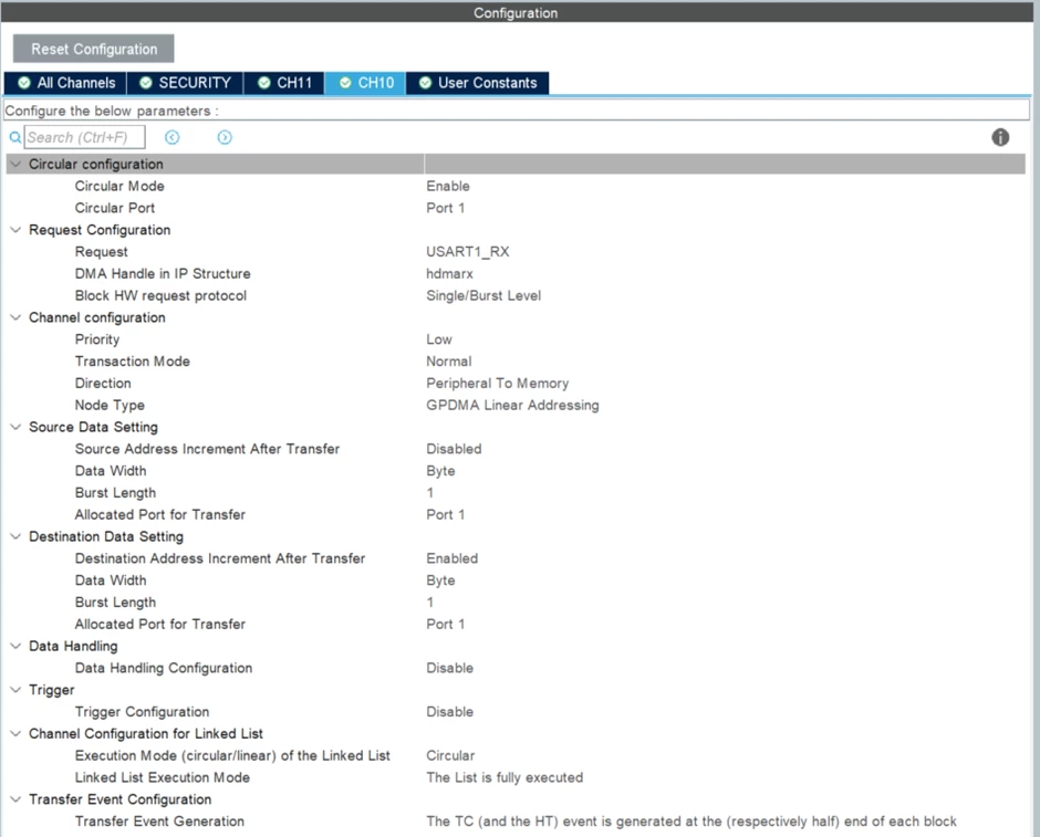

5. USART TX and USART RX configuration
OK, now that the difference is clear, let’s configure the 2 channels: one will be used for USART TX and the other one for USART RX. Just for the sake of showing that both Ports work with the same peripheral, the TX will use Port0 and RX will use Port1.
Here is the configuration for the TX:
Here is the configuration for the RX:
These were all the needed steps, so we can now generate the code (Alt+K).
