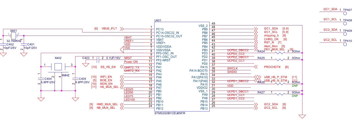

The PCB has basic functionalities like displaying battery power via LED lighting, charging battery and discharging and couple of WIFI, BT modules that are connected to the MCU - STM32G0B1CEU6N microcontroller (MCU)

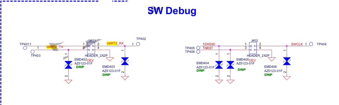

Upon looking at the schematic - the PCB has SWD and JTAG.

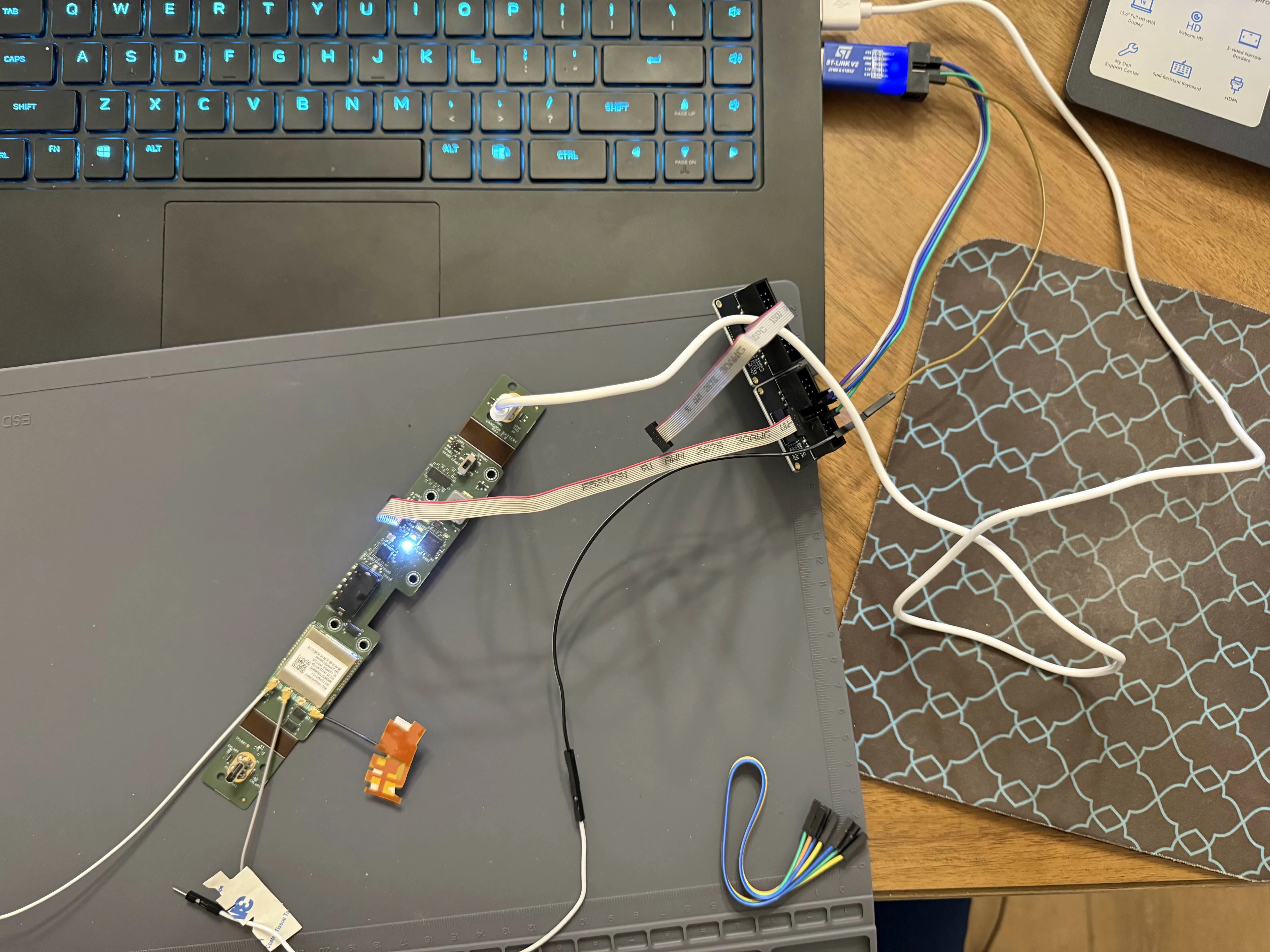

I tried connecting the PCB via ST-LINK-V2 to STM32Programmer but the software does not detect at all.
I checked the SWDIO, SWCLK, NRST, GND wiring (made sure they are all correct by checking continuity) gave VDD power input to the 3.3 V input on ST-LINK-V2 but no luck.
What i would like to understand is that could this be an RDP issue? where RDP level 1 is blocked and i need to connect via JTAG to enter the MCU and be able to flash it?

A few possiblities:
  • If it's in RDP level 2, the SWD port is disabled and no connection is possible. (If it's in RDP level 1 or level 0, you can still connect to it).
  • It's miswired.
  • The knock-off programmer you are using doesn't work correctly. Solution would be to use a genuine programmer.
  • Hardware is damaged.
