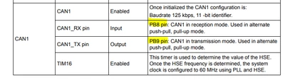

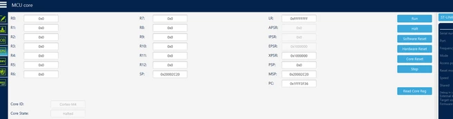

Then I made sure I'm in the bootloader from STM32 Programmer. That the PC (Program counter) in the Bootloader range (at 0x1FFF0000)
PC
And I followed the flow chart in AN2606, and AN3154(CAN protocol used in the stm32 bootloader).
But it not responding, I'm able to send and receive can messages between my STM32L433 Neucluo Board and Beagle Bone AI (using python in BB AI) before STM32 enter Bootloader mode, but AFTER the stm32 enter the bootloader mode it will not response to any message.
