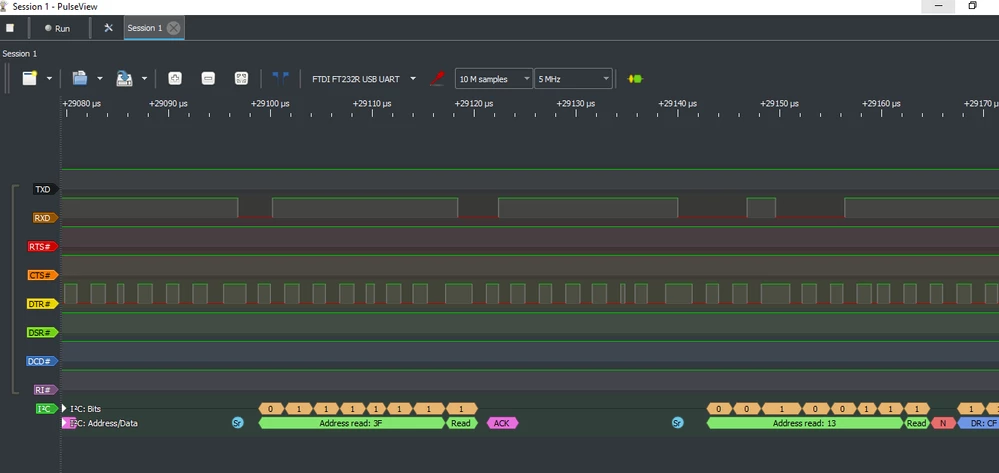

This is the sda and SCL traces captured with the logic analyzer. RXD--> SDA / DTR--> ClK

the SCL is stretched low permanently and SDA is pulled high, it seems that the master ( MCU) is blocked into these events ( EV6 or EV8_1).
but when i'm using if ((I2C1->SR1 & I2C_SR1_ADDR) ==0) with if, the problem get resolved and i can see the traces.
2) i cannot see the data that i have sent in the traces : as described in the main function I2C_send ( 0x3F, 0x55)
3) The LCD slave adress is 0x3F, but when i disconnect the LCD , i still receive the ACK ( Read and Write) as shown in the picture , is it normal ?
