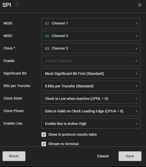

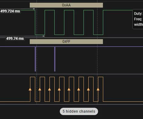

Hi everyone! i am using stm32l0c6t6, i need use spi with register, because i need make function type: spiwriteread(uint8_t data), to write in the device Lora llcc68 and read the return register, but with hal i can´t. Then i have configurated the spi using register, but when transmit i read in the logic analyzer inverter data, example: i transmit spiwriteread(0x55); and the logic analyzer had 0XAA; i don´t know why this is ocurr because the configuration register is rigth. i going to put the complete code:
