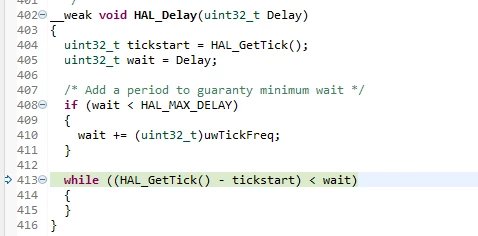

but after certain time period of execution lapse. STM32L433 goes to hardfault handler and executiion stucks,
After debug found that it stucks at HAL_Delay() function

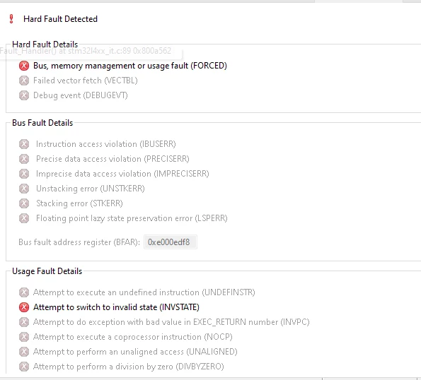

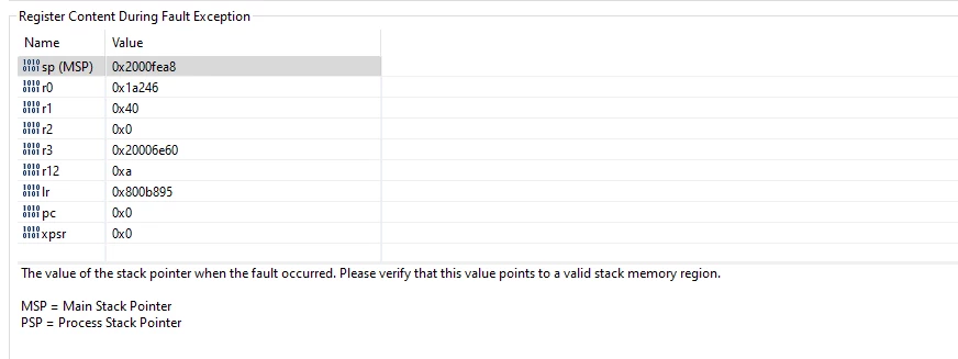

Check the STM32CubeIE Fault Analyzer output.
rahulgateAuthor
Associate
November 1, 2023
i have checked Fault Analyzer output i have attached fault analyzer log. Every time code is getting stuck in HAL_Delay() function.

That is why i asked you to post your code. I bet you are calling HAL_Delay() from inside an interrupt.

I see you commented out the HAL_Delay in this delay function. Is it still hard faulting?
void delay(int dly)
//	for(int d =0;d<dly;d++)
//		HAL_Delay(1);
	start_cnt = 1;
	cnt = 0;
	while(cnt < (dly / 8))
You've mentioned after certain time period of execution lapse so it can't be the other HAL_Delay before the main while loop. I assume you're getting your LED's to toggle?
So the "delay" function is the only place that calls HAL_Delay unless there is more somewhere else? You haven't shown all your functions so i don't know.
