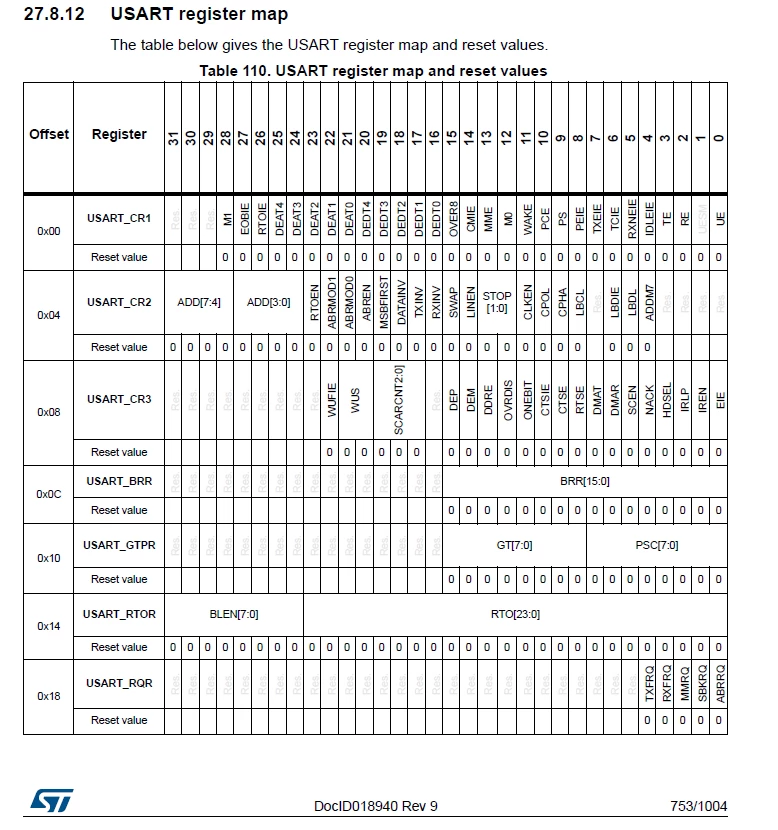

In manual DM00031936 (RM0091 Reference Manual) Section 27.8.12 Table 110 (partially copied below) tells me the offsets for the registers for a USART device, but not the definition of the individual bits/functions.
Which category of manual or reference document should I use to find this information?
