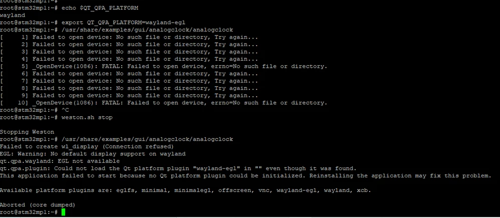

zqizh.1
zqizh.1Author
Associate III
March 7, 2022
Hi JM,
There is no difference, please see the log.
0693W00000Kbc4oQAB.pngRgds,
QiZhang
Jean-Marc B
ST Employee
March 7, 2022
Hi @zqizh.1​
I just rebuilt the st-example-image-qtwayland image and ran /usr/share/examples/gui/analogclock/analogclock without any trouble.
By the way, the environment variable QT_QPA_PLATFORM should not be set to wayland-egl but to wayland (it should be set by default when booting the board with the image as we see it from your log).
So there is another problem ;)
Which is your Distribution kit version please? Is it based on ecosystem-3.1 ?
Best regards,
--JM
 edit : fix for typo
