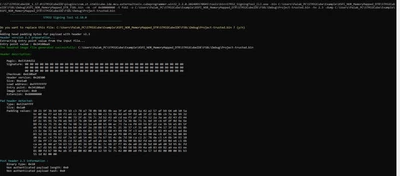

When the code is flashing first time it works, Green LED Blinks and UART Output is attached below.

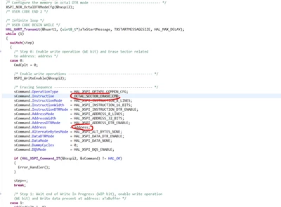

I have attached my code in which UART is added to verify board boot status.

The first time, your FSBL code is loaded in AXISRAM and it is executed correctlyt
In your code after configuring the Octoflash you are erasing the sector where the FSBL (sector 0) is loaded.
That's why in the next reset the Bootrom can't find any FSBL code in the flash to load and run in AXISRAM.
Hope that will help
