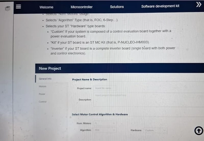

However, when we are looking on version 6.2 we don't see the window as shown in the wiki see attached.
Thanks in advance for helping us.
Kind Regards#
Guenther
here the doc window:
thats what we are seeing on 6.2

hi @Gboost ,
The interface changes a little, but the parameters remain the same, the same functionalities are offered to the user.
Regards
