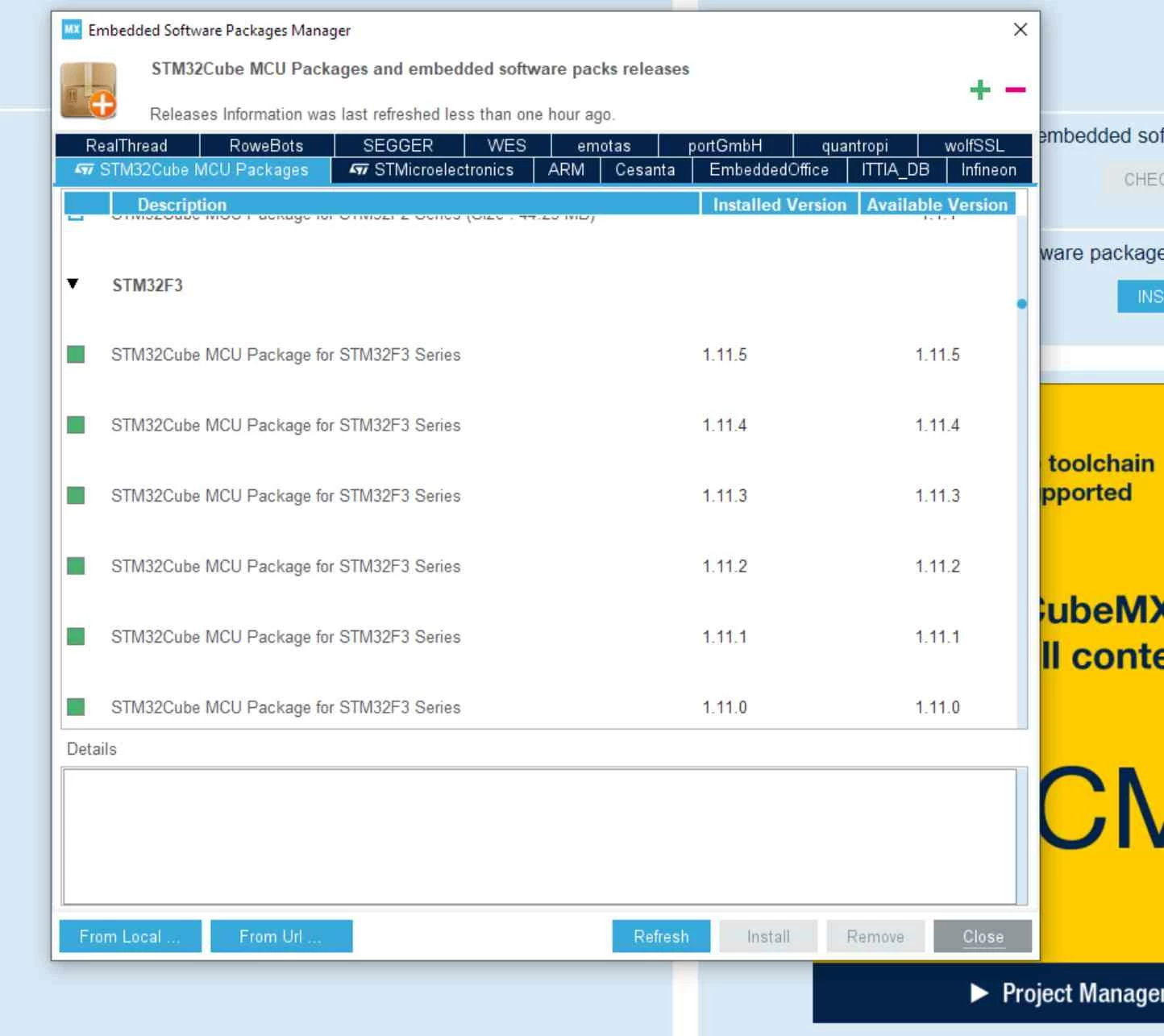

I downloaded CubeMX.
From the startup screen I assume I click on I need to >  Start my project from example > Access to example selector.
I'm using the 32F3348 DISCOVERY board. Neither this board or any STM32F3xx boards seem to be on the list.
I found the option to download packages in the Embedded software packs manager.
After seemingly installing anything referring to STM32F3xx from version 1.0.0 to 1.11.5 there are still no relevant examples after clicking on Access to example selector.
Then I saw the option to install from a local file and received the error "This package version is already available on the current STM32CubeMX repository"
Locally installed packages were: en.stm32cubef3.zipen & patch-cubef3-v1-11-5.zip
I assume I must be looking in the wrong place?
